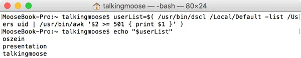

Over time, scripters build a library of “snippets”. A snippet is a little piece of more complex code that’s easier to copy and paste than rewrite each time. Here’s a great example (all one line):
 userList=$( /usr/bin/dscl /Local/Default -list /Users uid | /usr/bin/awk '$2 >= 501 { print $1 }' )
An advanced Mac scripter may understand what this does just by looking at it, but many scripters won’t without pasting it into Terminal and hitting return. This snippet runs the commands between the parentheses first and then takes the result and puts it into a variable named “userList”. Specifically, this snippet creates a list of all user accounts on a Mac with UIDs over 500. (All system accounts have a UID under 500.)
With a list of account names, the script can use a command to evaluate each one, get the path to its home folder and look for the three files that indicate the user has an Office 365 activation.

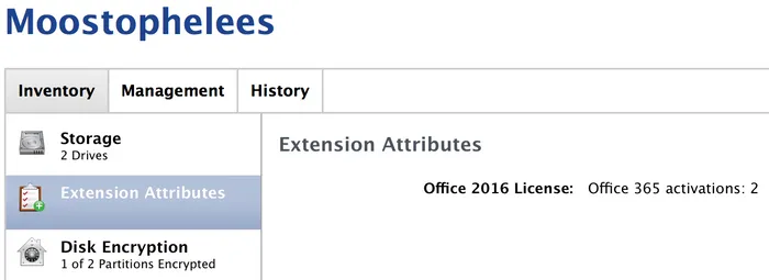

Add the script to the JSS as an extension attribute and run “sudo jamf recon” on a test machine. Then view the results of the extension attribute in the computer’s record or add it as criteria for an Advanced Computer Search or Smart Computer Group. Optionally, enable the new Smart Computer Group to show in the JSS Dashboard or email notifications when membership changes.
