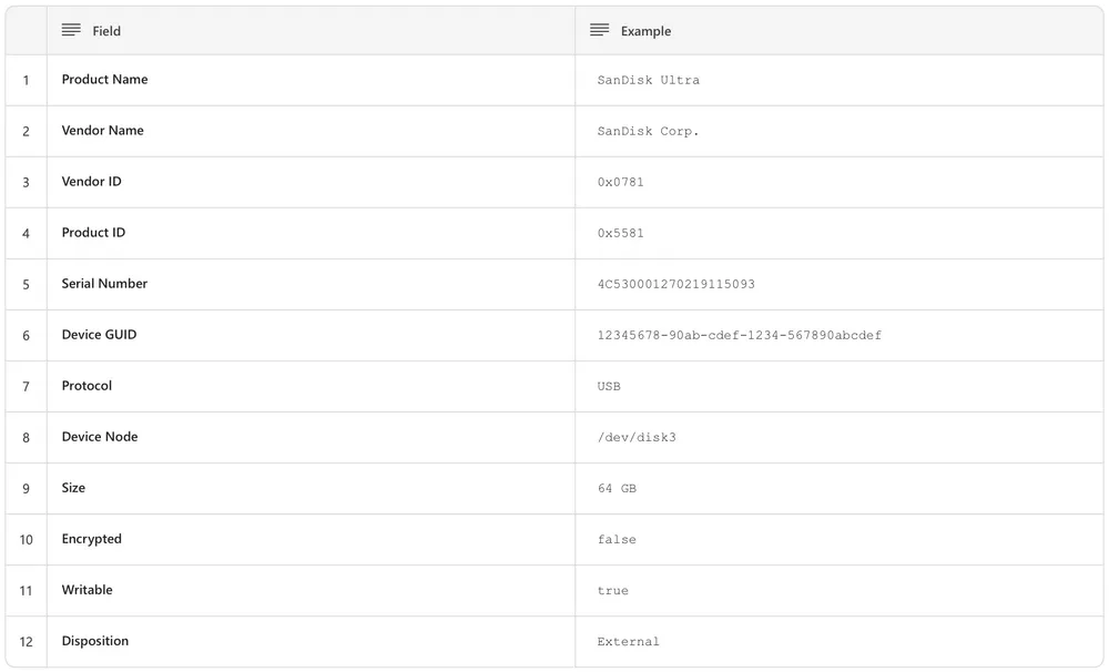

New: Hardware Device Metadata
Here’s a sample of the new fields now included:
Note: This is just a subset of available fields. For the full list, please refer to the Jamf Protect Telemetry data model documentation (requires Jamf ID sign-in).
