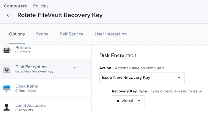

Bonus Feature: Rotate your FileVault Recovery Keys
Since you’re taking the time to make a Smart Computer Group that looks to see if this Deadpool of users file exists, chances are the user account created was made to reset a forgotten password for one of your users. This required IT to have procured the FileVault Personal Recovery Key to get into the computer before the change could be made.
This means someone now knows the key — maybe it was you, but then again, maybe not.
But that’s ok because there’s a fix for that too!
Simply create a second Jamf Pro policy with the payload “Disk Encryption” to “Issue New Recovery Key” to the machine. Set the trigger to Re-occurring check-in and scope to all machines in the Smart Computer Group you made to detect the Deadpool file. BOOM! Two problems are solved at once: we get rid of the unnecessary admin account(s) and we rotate the recovery key to secure it once again. The new key gets automagically escrowed in Jamf Pro thanks to a configuration profile made that redirects keys back to the device record.
