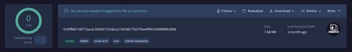

VirusTotal entry for newly discovered malicious file

In April 2025, Jamf Threat Labs discovered a suspicious Mach-O on VirusTotal named stl. Upon inspecting its behavior, it was clear this was yet another infostealer. While this write-up won’t dive deep into the stealer’s functionality, some initial behaviors were noted in VirusTotal:

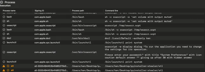

After some static analysis, it’s time to detonate the stl sample and observe its behavior dynamically using tools like eslogger or Red Canary Mac Monitor. During detonation with Mac Monitor running, we observed several exec events for osascript being invoked by stl, including an osascript -e display dialog prompt for the user’s password, muting the system volume and other common commands.
Execution events after detonating stl
At first glance, none of the commands imply that Python code is being executed. We don’t see Python being launched nor any obvious signs that Python modules are in use. But when we look at the execution event for the stl binary itself, a few things stand out in the environment variables.
  • _PYI_APPLICATION_HOME_DIR: reveals the temporary home directory PyInstaller creates at runtime
  • _PYI_ARCHIVE_FILE: shows the path to the actual PyInstaller executable that was launched
  • _PYI_PARENT_PROCESS_LEVEL: indicates the process level within the PyInstaller execution chain. For the stl binary, this is set to 0, meaning it’s the top-level process. In contrast, something like the osascript -e command used to prompt the user would have a value of 1, indicating it’s a direct child of the main PyInstaller process.

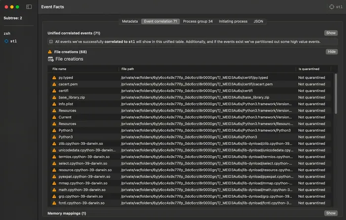

During detonation, we also captured file create, rename and unlink (delete) events. By inspecting the initial exec event of the stl binary and correlating related activity, we can see that before any logic executes, the binary unpacks all bundled Python libraries into its temporary home directory. These files aren’t persistent; they only exist on disk for the lifetime of the stl process.
Events correlated with the initial execution of the stl binary

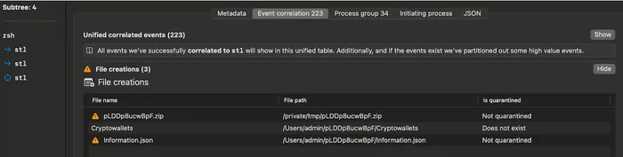

If we look at the second exec event of the stl binary and correlate the associated file create events, the files being written match exactly what we’d expect from an infostealer, pointing to clear data collection activity:
Events correlated with the second executed event, matching expected infostealer activity

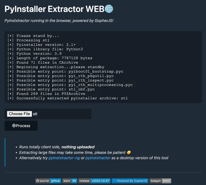

Now that we have a better understanding about how the malware is packaged and what its goals are, the next step is to unpack the Mach-O and decompile to see the true source of the executable (stl.py). To unpack the Mach-O, we can use Pyinstxtractor or pyinstxtrator-web, which are open-source tools used to extract the contents of a PyInstaller executable. Once the Mach-O is processed, an archive called stl_extracted.zip will be generated. Within that archive is the Python3.framework folder (Python3.9), associated dependencies, and stl_obf.pyc.
Pyinstxtractor unpacking the Mach-O

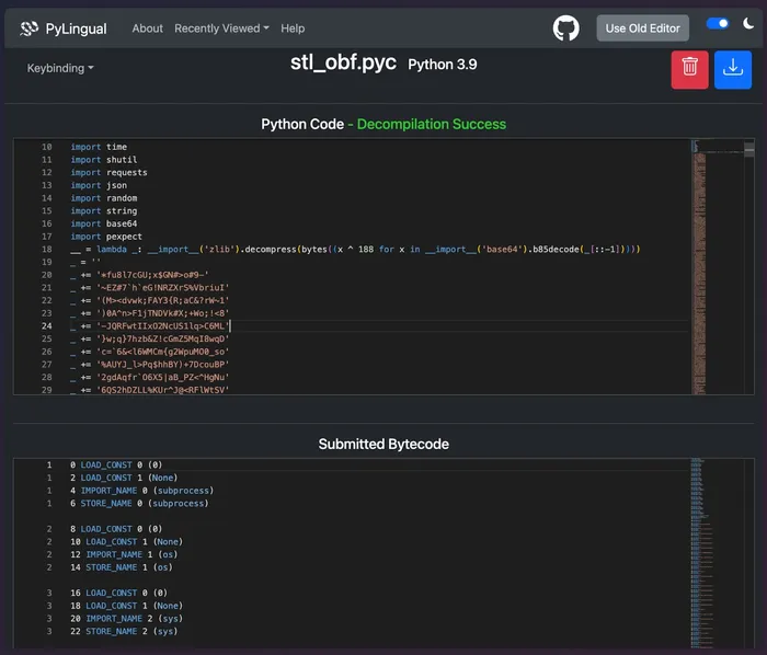

There are many tools to decompile Python bytecode, such as Decompile++ and Uncompyle6, but we will use PyLingual. It offers a web portal but can also be built and run locally. A handy feature of PyLingual is that it automatically identifies which Python version is needed to decompile the bytecode. One note about PyLingual, if you use the web portal, anything you upload will be retained to support future research and development. Now that we’ve got that out of the way, let's see what the decompiled Python script looks like.
PyLingual decompiling the bytecode
The decompiled Python code reveals that the script is further obfuscated by a combination of:
  • string reversal
  • base85 encoding
  • XOR'd bytes (encryption key = 188)
  • zlib compression
Modifying the last line of the script to print the contents of the obfuscated payload instead of running exec(__(_)), reveals the original state of the Python script including the steps taken to build the PyInstaller binary.
