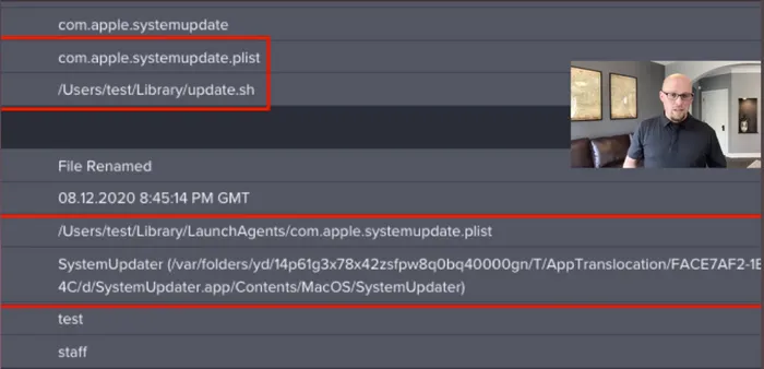

In any situation where the system detects a LaunchDaemon name with the prefix "com.apple" but the executable that is being prompted is not signed by Apple, this PlistDisguisedAsApple alert fires. As we can see in the SystemUpdater application in question, the plist name implies it is owned by Apple and should go on to execute a process signed by Apple but instead it goes on to execute an unsigned executable. This is suspect and requires further investigation.
image:alt_text
File types and naming also come into play in this initial assessment of the generated alert. In Processes, you’re able to view additional information for greater context.
You can see no developer signed or claimed this app; it was signed "Ad Hoc". Although this approach to signing information can be used for testing, malware often behaves like this and it should be a concerning data point in your assessment. The file is named com.apple.systemupdate.plist, but is sitting in the user's Library directory, attempting to run at startup as a shell script, which is indicated by /Users/test/Library/update.sh — and is another red flag.
If an executable file is in a user's library directory, which is generally meant to store additional directories rather than executables, this indicates further suspect behavior. We can also determine that, because the application is sitting in /AppTransloction/, this is its first time running on the system.

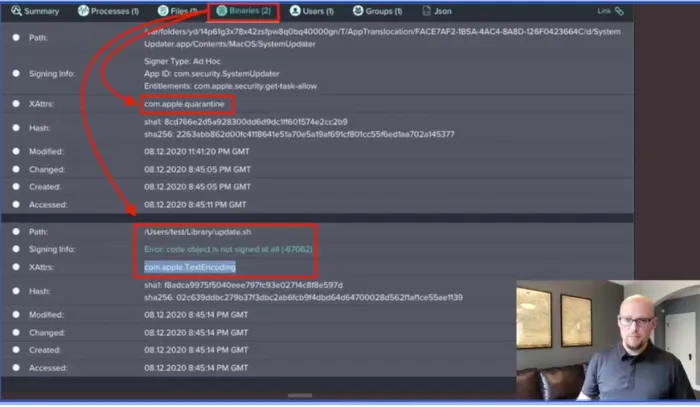

Within Binaries, you are able to see even more details about what the executables that are connected to this suspect process, and we are able to confirm that the application is quarantined within the logged extended attributes (XAttrs): com.apple.quarantine. This tells us that this file was download to the device from the internet from a web browser, chat mechanism or other internet-based action. We again are notified that this application is not signed and, in this same view, we can see additional XAttrs information. This time, the XAttrs: com.apple.TextEncoding does not convey information that sways us one way or the other in this situation, but it is an insight that can provide additional information to shape other incident response scenarios.
image:alt_text

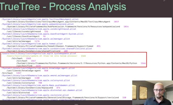

One of the best ways to catch malicious attacks is through process tree analysis. Bradley prefers to use TrueTree, written by Jaron Bradley himself! It is open-source, free and was designed to provide greater process analysis beyond what is natively available.
In the incident response script, we gained even greater insight into what occurred and the severity of the attack. Much of what is presented can be information we've already determined but it can often add additional context to your assessment.

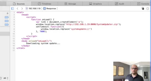

To take this one step further, we can visit the website and look at the source code. However, if you implement this step in your process, you should do so by using a secure process like a VN or over a proxy as to not infect the host system
image:alt_text
We can see that when a user visits the site, they are immediately redirected to a link with the SystemUpdater.zip; the zip file is automatically downloaded, followed by a seven-second hold to unzip the file and register run the custom URL scheme, and finally, the user is redirected to the CustomUrl scheme where they are prompted to open the application. We now have a full understanding of what took place at the exact moment of the security incident.
