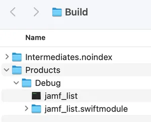

In Xcode, first select “Build” from the “Product” menu, to make sure the project is freshly compiled with all the code changes. Then, you can select “Show build Folder in Finder” from the “Product” menu. This will open a Finder window to the location where Xcode actually builds the binary.
There will be a “Products” folder with a “Debug” subfolder. Inside that “Debug” folder is the actual binary that Xcode has built for us. There will be other folders with temporary build data, but they are not interesting to us now.
Open Terminal. Drag the “Debug” folder onto the Terminal icon in the Dock. This will open a new Terminal window with the working directory set to this Debug folder. Then you can run the command in Terminal:
The location of the build folder and of the binary that Xcode builds will not change. So going forward, you can just re-build in Xcode (command-B), switch back to this Terminal window and try again. Using the Terminal interactively is very useful when you want to quickly iterate through different sets of arguments.

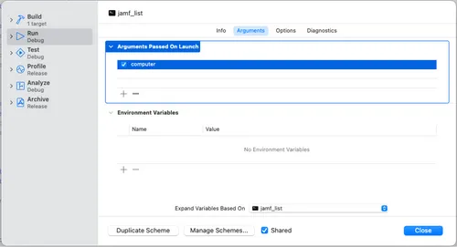

We can also tell Xcode to add arguments when it runs the command line tool inside its interface. This is very useful when you want to use the debugger interface.

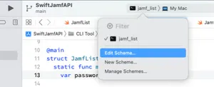

In the toolbar, click on "jamf_list" to get a menu. Select "Edit Scheme…"
(You can also find this in Product > Scheme in the main menu bar)
In the dialog that appears, select "Run" in the left column, then select the "Arguments" tab. Add the type you want to test with, e.g. computer in the "Arguments passed on launch" area. You can add more arguments here, one for each value, and disable the ones you do not want to use with the checkmarks.
Now run the project again. If you entered the arguments correctly, the tool should work.

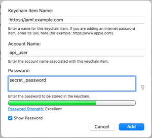

When you run the project with this, you will get the message “Could not get password from keychain” with an error number of 2. This is expected, because you (probably) have not stored the password in your keychain yet. Open the Keychain Access application, make sure you have selected the "login" keychain, then select "New Password Item" from the "File" menu.
In the window that opens, enter the server URL (including the https:// ) as the "Keychain Item Name," the user name as the Account Name and the password in the "Password" field. Then click "Add."
Note: It is important to create the password item in the "login" keychain. The iCloud keychain has stricter security restrictions than the login kechain. It is possible but quite difficult to let a command line tool access keychain items in the iCloud keychain, but that exceeds the limits of this tutorial. This is also the reason our command line tool cannot find passwords you may have stored when accessing the Jamf interface in Safari.
When you run the tool again, it should retrieve the password from the keychain. You will get a prompt to authorize the access to the keychain. Confirm with your password. Click "Always Allow" to avoid this prompt every time you run the tool.
