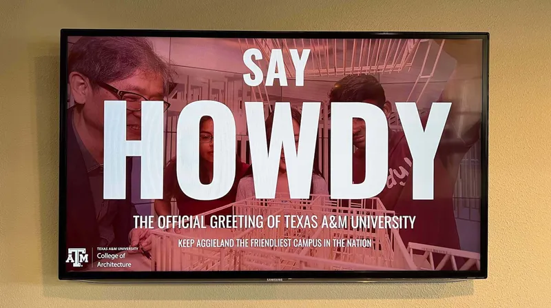

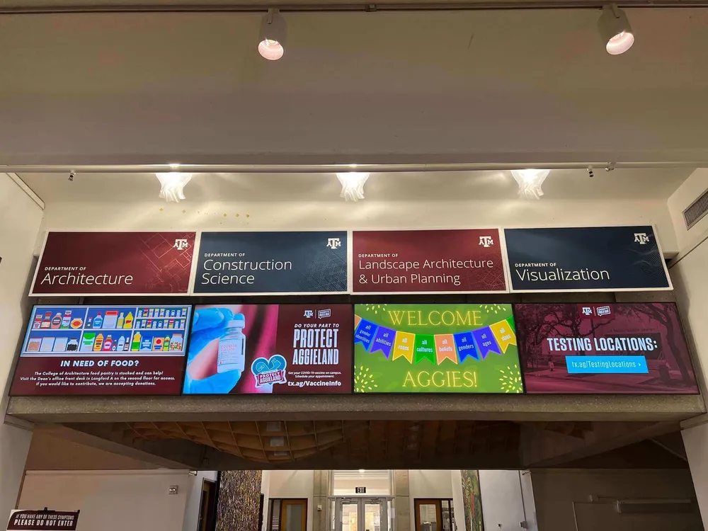

The Texas A&M College of Architecture had a solution for digital signage, but it was proving to be time-consuming and inflexible. They used a PowerShell script that would pull PowerPoint files out of FileShareon a schedule, but the system broke constantly and required on average about three to four hours of maintenance a week to keep it in working order. When a mistake or a last-minute schedule change called for a change in the signage, the update would routinely require eight to twelve hours to populate.
When Johnson traveled from College Station to Dallas to take his Jamf 200 training, he asked about mobile device configurations that might help solve their digital signage problem, and one of the solutions that the instructor suggested was Carousel Digital Signage. After the school locked down for the pandemic, he worked on configuring the college’s tvOS devices with Jamf Pro and Carousel, marveling at how easy the process was. The director of the on-site makerspace even used a 3-D printer to create custom cradles for the Apple TV brackets, and the new signage solution blended seamlessly into both the network and physical architecture.
One of the primary results of using the Jamf + Carousel combination is that the communications department, which is responsible for creating the messaging on the displays, can publish and update their own content without IT having to intervene, even in the case of emergency notifications. Having such an elegant solution means that the admins can scale easily, simply installing new devices, deploying software remotely and leaving daily operations in the hands of the communications staff.
