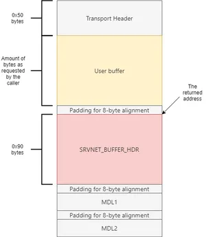

As we already mentioned in our local privilege escalation research, the SrvNetAllocateBuffer function doesn’t just return a buffer with the requested size. Instead, it returns a pointer to a struct that is located at the bottom of the pool-allocated memory block, containing information about the allocated buffer. The layout of the pool-allocated memory block is the following:
While our reading technique can only read bytes from the “User buffer” region, we can use the integer overflow bug to copy parts of the SRVNET_BUFFER_HDR struct to the “User buffer” region of another buffer, which we can then read. We can do that by setting the Offset field to point at the SRVNET_BUFFER_HDR struct beyond the data we want to read. We just need to make sure that the data that is located there can be interpreted as valid compressed data, otherwise the copying won’t happen.

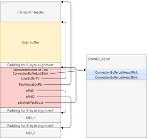

Let’s take a look at the fields of the SRVNET_BUFFER_HDR struct and see whether there’s something worth reading:
The colored variables are pointers. The blue-colored pointers all point inside the pool-allocated memory block, with offsets which can be calculated in advance, so it’s enough to read one of them. Having an absolute pointer to the pool-allocated memory block will surely be helpful. Regarding the orange-colored pointers:
  • ConnectionBufferList – A linked list of all of the received, unhandled buffers of a connection. The list head is a part of the connection object created by the SrvNetAllocateConnection function in srvnet.sys. A buffer is added to the list by the SrvNetWskReceiveComplete function. In our case, there will be only one buffer in the list, so both pointers (Flink and Blink of the LIST_ENTRY struct) will point to the list head inside the connection object.
  • pSrvNetWskStruct – Initially, a pointer to the connection object mentioned above. The pointer is set by the SrvNetWskReceiveEvent function, but is overridden by the SrvNetWskReceiveComplete function with the pointer to the SRVNET_BUFFER_HDR struct. Thus, reading it is not more useful than reading one of the other blue-colored pointers. By the way, if you search for “pSrvNetWskStruct“ you’ll find out that it played a role in exploiting EternalBlue.
  • TracingPtr1/2 – These pointers are only used when tracing is enabled, as it seems.
As you can see, the only other useful pointer for us to read is one of the pointers from the ConnectionBufferList struct. Both pointers (Blink and Flink of the LIST_ENTRY struct) point to the connection object. The object struct has been named SRVNET_RECV by EternalBlue researchers, so we’ll use this name as well.

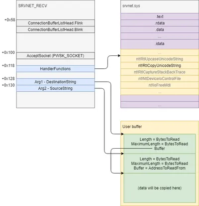

Given that we have the base address of the srvnet.sys module, we can call any of the module’s functions. But what about the function’s arguments? The srv2!Srv2ReceiveHandler function is called by SrvNetCommonReceiveHandler, and the call looks like this:
The first two arguments are read from the SRVNET_RECT struct, so we can control them. We don’t have as much control over the other arguments. The x86-64 calling convention specifies that it’s the caller’s responsibility to allocate and free the stack space for the arguments, so even though a 8-arguments function is intended to be called, we can replace the pointer with a function that expects any other amount of arguments, and it will work.
  1. Send a specially crafted message so that the connection’s SRVNET_RECT struct pointer will be copied to a buffer we can read.
  2. Send another, valid message, which will reuse the same SRVNET_RECT struct, but don’t close the connection yet. Note that when a connection is closed, the SRVNET_RECT struct is not freed. The SrvNetPrepareConnectionForReuse function is called to reset the struct so that it can be reused for the next connection.
  3. Read the SRVNET_RECT struct pointer that we copied in step 1.
  4. Replace the HandlerFunctions pointer and the arguments using the write-what-where primitive.
  5. Send an additional message over the connection from step 2 so that the function that took the place of srv2!Srv2ReceiveHandler is called.
Now all we had to do was to find a convenient function to copy memory from one location to another, so that we can copy arbitrary memory to the pool buffer we can read from. memcpy comes to mind, and srvnet.sys does have such a function (memmove, to be precise), but this function requires a third argument, the amount of bytes to be copied, which we don’t control. Failing to find a convenient function that requires one or two arguments, we realized that we’re not limited by functions implemented in srvnet.sys, we can also call functions from srvnet’s import table by pointing HandlerFunctions at the right offset. There, we found the perfect function: RtlCopyUnicodeString.
The RtlCopyUnicodeString function gets two UNICODE_STRING pointers as arguments, and copies the content of the source string to the destination string. Unlike C strings which are NULL-terminated, strings in the kernel are defined by the UNICODE_STRING struct which holds a pointer to the string, and the string’s length in bytes. The string buffer can hold any binary data. If you peek at the implementation of RtlCopyUnicodeString, you can see that the copying is done with the memmove function, i.e. plain binary data copying. All we have to do is prepare our two UNICODE_STRING structs and call RtlCopyUnicodeString, then read the copied data:

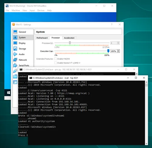

Launching a reverse shell
Technically, we achieved remote code execution, so we could stop here. But if we’re not popping calc or launching a reverse shell, the POC is not complete, so we went on to fill that gap. Since our shellcode runs in kernel mode, we can’t just run cmd.exe or calc.exe and call it a day. We needed to find a way to get our code to run in user mode. While searching for prior work on the topic we found sleepya’s shellcode, written originally for EternalBlue exploits, which is designed to do just that.
In short, here’s what the shellcode does:
  1. Hook IA32_LSTAR MSR to lower the IRQL (Interrupt Request Level) from DISPATCH_LEVEL to PASSIVE_LEVEL. The shellcode begins execution at the DISPATCH_LEVEL IRQL which imposes several limitations. For more information see the great explanation of zerosum0x0.
  2. Find a privileged user mode process (lsass.exe or spoolsv.exe) and queue a user mode APC in one of the alertable threads that is in waiting state.
  3. In the APC kernel routine, allocate EXECUTE_READWRITE memory and point the APC normal (user mode) routine there. Then copy the user mode shellcode to the newly allocated memory, prepended with a stub to create a new thread.
  4. In the APC normal routine a new thread is created, executing the user mode shellcode.
Published about three years ago, the shellcode didn’t work right away on recent Windows versions, so we had to make a couple of adjustments:
  1. Incompatibility with the KVA Shadow mitigation. In the blog post Fixing Remote Windows Kernel Payloads to Bypass Meltdown KVA Shadow zerosum0x0 explains why the first part of the shellcode, IA32_LSTAR MSR hooking, isn’t supported when the KVA Shadow mitigation is enabled, and proposes a fix. We tried the proposed fix, but it didn’t work on newer Windows versions – zerosum0x0 targeted Windows 10 version 1809 while we were targeting versions 1903 and 1909. The right thing to do is to improve the fix or find another solution, but we just removed the IRQL lowering part. As a result, the POC can sometimes crash the system while trying to access paged memory (bug check IRQL_NOT_LESS_OR_EQUAL), but it doesn’t happen often, so we left it as is since it’s good enough for a POC.
  2. Fixed finding the base address of ntoskrnl.exe. At first, we tried using zerosum0x0’s method – get an address of the first ISR (Interrupt Service Routine), which is located in ntoskrnl.exe, and search for a nearby PE header. The method didn’t work for us since the ISR pointer points to ntoskrnl’s INITKDBG section which is not mapped. Since we already found the ntoskrnl.exe base address, we fixed it by just passing it as an argument to the shellcode.
  3. Fixed a problem with finding the offset of ETHREAD.ThreadListEntry. The original code looked for the current thread in the thread list of the current process. The thread won’t be found if the current thread is attached to a different process than the one it was originally created in (see KeStackAttachProcess).
  4. Fixed the UserApcPending check in the KAPC_STATE struct for Windows 10 version R5 and newer. Since Windows 10 version R5 UserApcPending shares a byte with the newly added bit value, SpecialUserApcPending.
With the above fixed, we finally managed to make the shellcode work, we just needed to fill in the user mode part of the code to run. We used MSFvenom, the Metasploit payload generator, to generate a user mode shellcode to spawn a reverse shell.
