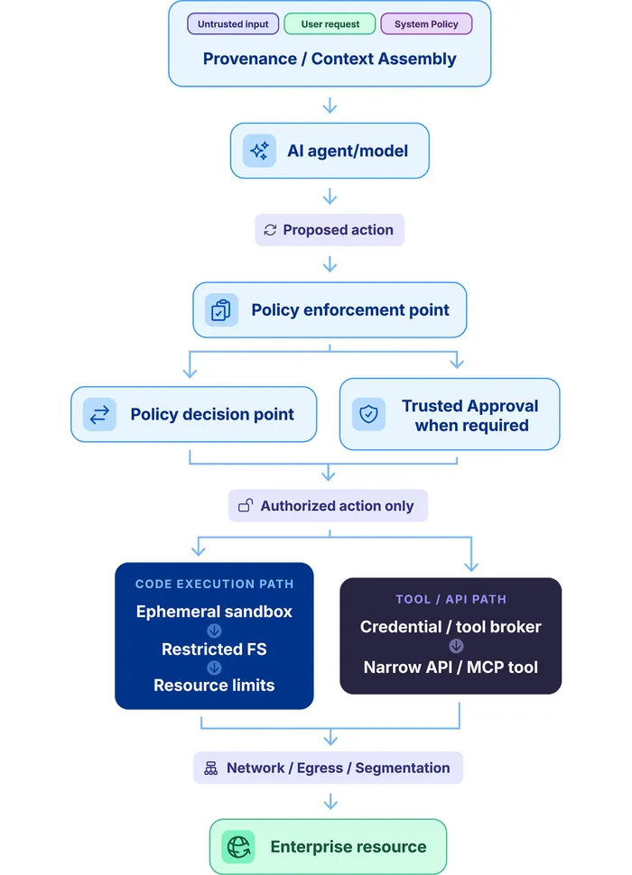

The agentic security control plane
The complete architecture can be organized into five connected security planes:
- Governance and classification
- Execution and network containment
- Identity, credentials, tools and MCP
- Authorization and action safety
- Input trust, visibility, resilience and recovery
No individual plane is sufficient on its own. For instance, a stronger sandbox cannot compensate for an over-privileged cloud token, nor can an approval workflow compensate for missing logs or unusable backups.
The AI model is only one component of how AI fits into your systems. The model proposes actions; it does not authorize or directly execute them. Understanding how this authorization happens is important to your AI security.
Generated code executes within an isolated runtime path. Enterprise API and MCP operations pass through mediated tool and credential paths. Both remain subject to authorization, network restrictions and independent monitoring.
Audit telemetry should be collected from the context layer, agent, policy enforcement point, policy decision point, approval system, credential broker, sandbox, tool gateway, network controls and destination service.
The architecture is layered to constrain different forms of authority based on the operation performed, which is why it’s crucial to defend all five security planes.
