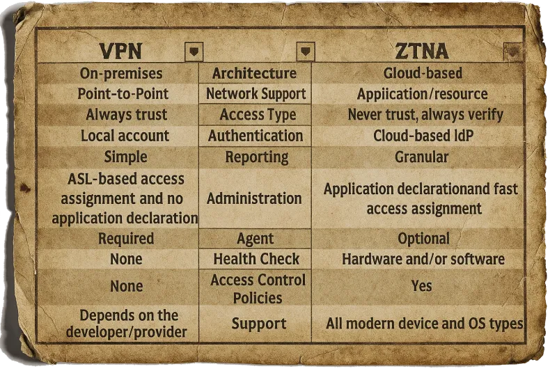

A quick takeaway of the similarities and differences between ZTNA and VPN is presented below, allowing careful examination of the capabilities of each technology. As you compare both sets of features to the unique needs of your remote or hybrid work environment, try to answer the question, can Zero Trust replace my VPN?
The choice is yours. But luckily, you’re not alone – Jamf for Mac has your back, front and sides covered!
