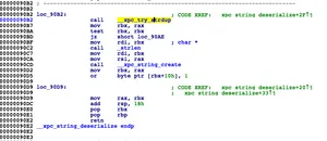

Let’s look at OS_xpc_string first. When deserializing OS_xpc_string, the function xpc_string_deserialize calls xpc_try_strdup which is a wrapper of strdup, as shown below.
By controlling the length of the string, we are able to control the size of the allocation. Adding multiple OS_xpc_string objects into deserialized dictionary or array may also increase the filling rate.

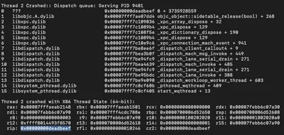

Now we can finally control the PC:

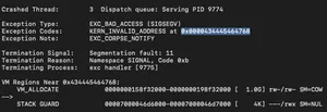

When we change the first 8 byte of the string into 0x180202020, in a 64bit operating system, the pointer is actually 0x0000000180202020, which means if we set the 1st 8 byte of the string into an address we want, the zeros will terminate the string at the 5th byte. The string is likely allocated somewhere else since OSX uses size-based free list to speed up allocations.
