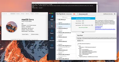

This image shows a machine that is updated to macOS Sierra 10.12.6 and XProtect configuration version 2095. UXProtect shows that the XProtect signatures are the most recent available, including signatures for HMining.D and the renamed ExtensionInstaller.A as part of the most recent update.

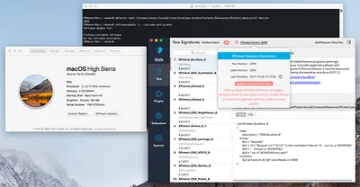

After this same machine is updated to macOS High Sierra, we can see that the XProtect signatures have now been reverted to v2094 and that SoftwareUpdate does not believe that there is an update available.
UXProtect also now shows that v2094 is installed. The HMining.D and renamed ExtensionInstaller.A signatures are no longer a part of the package. However, UXProtect properly notes that v2095 is available for download and prompts the user to take action. As you might suspect this fails because UXProtect calls upon SoftwareUpdate to install the package.
