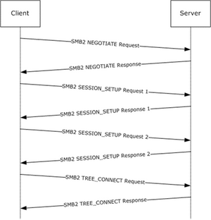

After skimming over the protocol specification and debugging a couple of sessions, we saw that a regular flow begins with the following commands that are sent by the client:
SMB2 NEGOTIATE → SMB2 SESSION_SETUP → SMB2 SESSION_SETUP
If incorrect credentials are used, the session is aborted after the second SMB2 SESSION_SETUP request.
We assume that we don’t have valid credentials, so we checked whether other commands can be sent without authentication. We found the following after some experimentation:
- The first command to be sent must be SMB2 NEGOTIATE. It also must be the only SMB2 NEGOTIATE command during the session.
- The subsequent commands, until authentication completes successfully, must be SMB2 SESSION_SETUP. That is unless anonymous access to named pipes or shares is not restricted, and it is by default.
Since the SMB2 NEGOTIATE message is not compressed (the compression algorithm, if any, is decided during the negotiation), all that’s left is SMB2 SESSION_SETUP. So we took a closer look at the format of the SMB2 SESSION_SETUP message, hoping to find a way to get some of the data that is being sent back.
